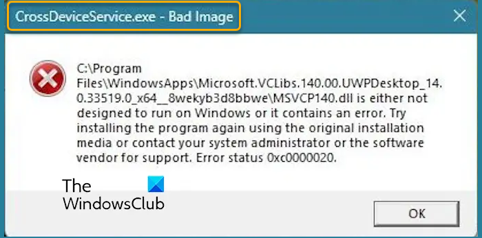

Some users have reportedly been experiencing the following errors on their Windows computer:
CrossDeviceService.exe Bad Image
CrossDeviceService.exe, The parameter is incorrect
MSVCP140.dll is either not designed to run on Windows or contains an error. Error status 0xc0000020.
The primary cause of this error could be a damaged program installation, corrupted operating system files or hard disk issues. A corrupted Visual C++ component or missing Cross-Device Experience Host can also cause this issue.

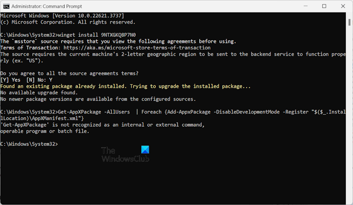

4] Update Cross-Device Experience Host via Windows PowerShell
It might be the case that the Cross-Device Experience Host component is not up-to-date or missing from your computer which is resulting in this error. Hence, if the scenario is applicable, update the Cross-Device Experience Host component to fix the error. Here are the steps to do that:
First, run Command Prompt with administrator privileges. After that, type the below command:
winget install 9NTXGKQ8P7N0
Now, press the Enter button.
Next, press Y when asked “Do you agree to all source agreements terms?”
Finally, check if the error is fixed.

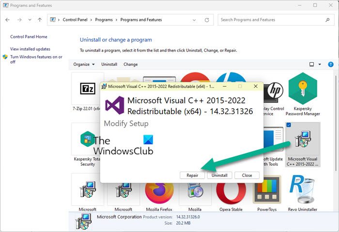

5] Reinstall Microsoft Visual C++
The error could be caused by a corrupted installation of Microsoft Visual C++. If this scenario applies to you, reinstall the Microsoft C++ package on your PC and check if it resolves the error.

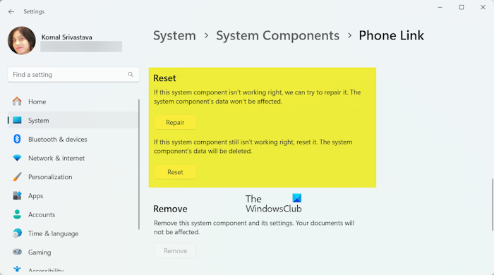

6] Reset or Reinstall the problematic app
If the error persists, you can Reset or Uninstall the problematic app which is causing this error. Many users have reported experiencing this error with Phone Link.
- First, open the Settings app using Win+I.
- Now, go to the System > System components section.
- Next, click on the three-dot menu button associated with the Phone Link app.
- After that, select Advanced options and then click on the Reset button.
- Once done, see if the error is resolved. If not, use the Remove feature and check if it helps.
Once the app is removed, restart your PC and install Phone Link from the Microsoft Store.
