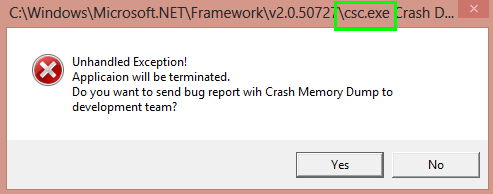

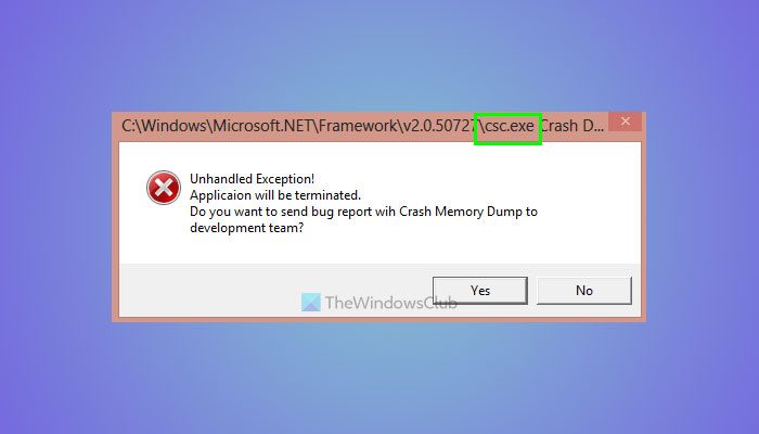

Csc.exe is a C# compiler that comes with Microsoft’s .NET Framework. Although we have covered .NET Framework issues on this site, the csc.exe error is of a different breed. When you try to shut down your computer, it normally goes smoothly – but not always. Due to some factors, you can get the csc.exe error.
You have to get rid of the csc.exe error quickly because without doing that, your machine will go off randomly, and you can’t make use of your computer. In the section that follows, I’ll walk you through the steps for fixing this problem on your Windows 11/10 computer.

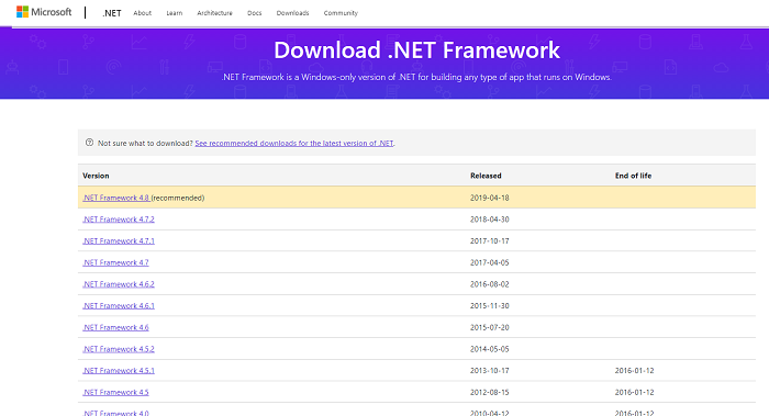

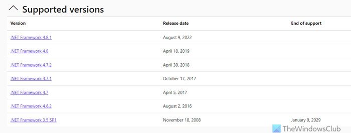

1] Re-install or update the .NET Framework
The legitimate csc.exe file works with Microsoft’s .NET Framework. By default, your machine has this installed, but if issues arise with the .NET Framework on your computer, then the csc.exe error can show up.
You can also encounter this error if you’re using an outdated version of the framework. The most common fix for the csc.exe error is to uninstall the .NET Framework, then download the latest version of the framework, and reinstall it on your computer. On the download page, ensure that you download the recommended version at the top of the list. That’s the most recent one.
