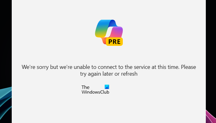

In this article, we will see how to fix the “Unable to connect to the service at this time” error while in Copilot. Microsoft Copilot is an AI assistant in Windows 11 that helps users complete multiple tasks on their systems.
We’re sorry but we’re unable to connect to the service at this time. Please try again later or refresh.
Fix Copilot unable to connect to the service at this time error
If the error “Unable to connect to the service at this time” occurs in Copilot, you cannot use it until you fix this error. You can use the following suggestions to fix this error:

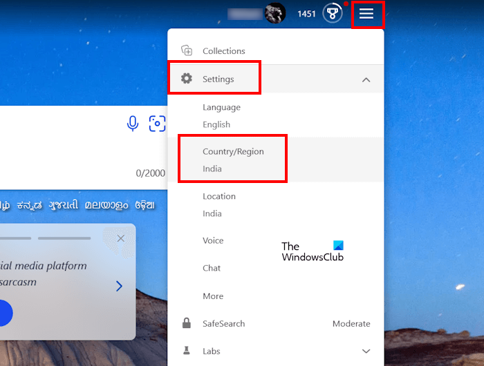

2] Check your location in Bing
I experienced this error while using Copilot. Strangely, when I checked my location in Bing, it was set to some other country. Maybe Copiot was not available in that country. However, when I searched for information regarding Copiot’s region-based availability, I did not find any information. When I changed my location in Bing to India, the error was fixed. It would be best if you also tried this.
Check your location in Bing. To do so, use the following steps:
- Open Edge.
- Open the Bing search engine or go to bing.com.
- Ensure you are signed in to Edge with your Microsoft account. Now, click on the Hamburger menu or three horizontal lines on the top right side of Bing and select Settings.
- Click on the Country/Region option and select your correct location.
