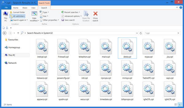

You can also try different ways to open the Control Panel. Open File Explorer, type the following in the address bar, and hit Enter to open your System32 folder:
%SystemRoot%\System32
Search for *.cpl in this folder. The results will display all the Control panel applet files.
Click on appwiz.cpl and see if the main Control Panel window opens. If it does not, then from the WinX menu, open Run, type appwiz.cpl, and hit Enter. Does the main Control Panel window open? If not, then it is quite possible that some .cpl files may have been damaged or corrupted.
Click each one and see if the related Control Panel tool opens. If something does not, then it means that that particular .cpl file has been corrupted or damaged.

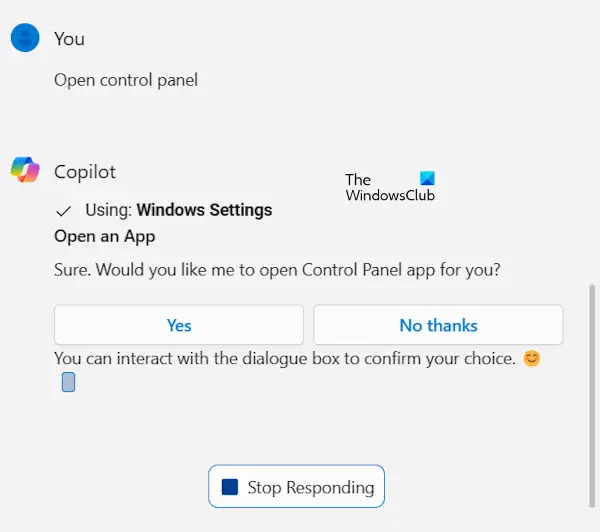

Windows 11 users with the latest build can also use Microsoft Copilot to open the Control Panel. Open Copilot, type the following prompt, and press Enter.
Open Control Panel
Copilot will ask you to open it or not. Click Yes.

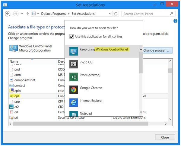

5] Check and set the File Association for Control Panel files
Check and set the File Association for Control Panel files and see if it helps. Now I am aware that you are unable to open the Control panel, but if via the System32 folder as described above, you can click open inetcpl.cpl, then please do so. Then under its Programs tab, click on the Set Associations button, under the File Associations section to open the following window.
Here check if .cpl files are set to open with the default Windows Control Panel. If not set it so.

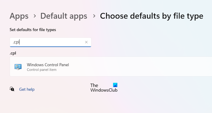

In Windows 11, you may not find the Set Associations button under the Programs tab in the Internet properties window. Therefore, use the following steps to check the File Associations on Windows 11:
- Open Windows 11 Settings.
- Go to Apps > Default apps.
- Scroll down to the Related Settings section and click on the Choose defaults by file type tab.
- Type .cpl in the search bar.
- The Windows Control Panel should be selected for the .cpl file association. If not, select the Windows Control panel.

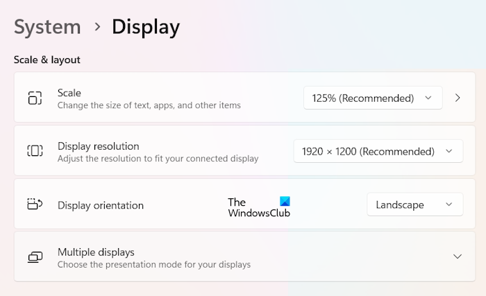

6] Change your display resolution and scaling
Sometimes, the incorrect display resolution and scaling can cause problems. We suggest you change your display resolution and scaling; and see if it helps. First, select the Recommended settings. If this does not work, try another option.
Open your system settings and go to System >Display. There, you will see the options to change the display resolution and scaling.

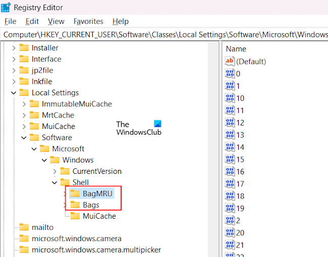

7] Modify Windows Registry
You can also modify the Windows Registry and see if it works. Before you proceed, we recommend you create a System Restore Point and backup your Registry. This will help you restore your system if any problem persists.
Open the Registry Editor and go to the following path:
Computer\HKEY_CURRENT_USER\Software\Classes\Local Settings\Software\Microsoft\Windows\Shell
Now, expand the Shell branch and delete the following two subfolders:
- BagMRU
- Bags
Do not delete any other Registry key or folder. After doing this, the issue should be fixed. If this creates a problem, you can revert the changes by performing System Restore.
