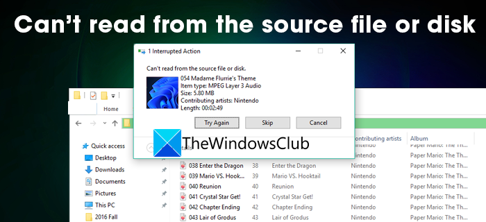

If you are seeing Can’t read from the source file or disk while copying in Windows 11/10, we have a few solutions using which you can fix it. This error can be caused by many reasons like corrupted files, lose connections, incompatible file systems, etc. You can fix them easily using the methods mentioned below.
When you see the error while copying, first check if the device is properly connected and restart your PC. Then, follow the fixes below that can resolve the issue.
