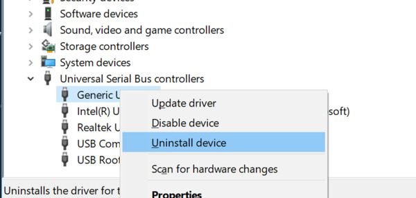

5] Reinstall the drivers for USB controllers
- Open Control Panel and navigate to Device Manager
- Select and expand Universal Serial Bus controllers
- Right click on each USB controllers and click Uninstall Device from the menu.
Once done, restart Windows to reinstall all the driver’s controllers.
