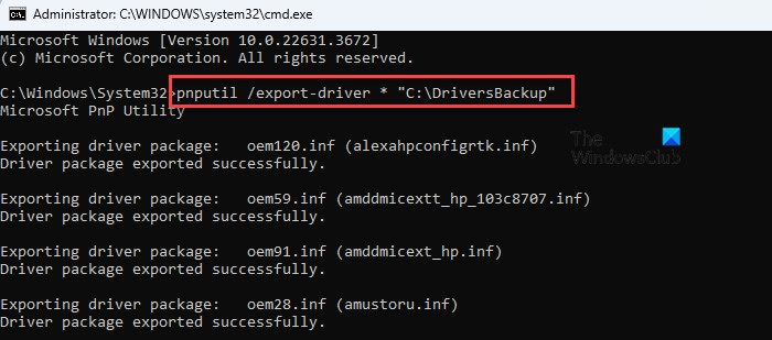

2] Backup & Restore Drivers using PnPUtil
PnPUtil is a command-line utility used to manage the driver store in Windows. It can be used to add, delete, and enumerate driver packages, as well as export drivers from the driver store.
You may use PnPUtil to export all installed drivers from the current Windows installation to a specified directory. To do so, follow these steps:
Open Command Prompt using administrator privileges, type the following command in the Command Prompt window, and press the Enter key:
pnputil /export-driver * "D:\DriverBackup"
The asterisk (*) is a wildcard character that indicates all drivers. When used with pnputil /export-driver, it means export all drivers.
Once the command is executed, you will see a ‘Driver package exported sucessfully.’ message. Along with this, the tool also lists the number of total driver packages and exported driver packages.
This is how you backup your drivers using PnPUtil. To restore drivers, execute the following command in an elevated Command Prompt:
pnputil /add-driver "D:\DriverBackup\*.inf" /subdirs /install
The above command will add and install all driver packages found in ‘D:\DriverBackup’ and its subdirectories.
