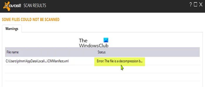

3] Check and resolve Decompression Bomb issue
For most affected users, the most common reason for the errors in focus is that Avast believes it is handling a file that when uploaded can cause a DoS attack. The file in question is usually referred to as “decompression bomb” – a term for chronic documents (RAR or ZIP) with a high compression rate. When extracted, these documents can become very large, occupying all the disk space and hogging system memory as well. These “decompression bombs” are used repeatedly in DoS attacks by threat actors with the intention to weaken and incapacitate virus scanners; but due to the majority of security tools being able to detect this practice, the security software won’t scan the archive in order to avoid crashing the system or making it more vulnerable to attacks.
So, if this is the case for you, the best way to resolve the issue you are currently facing is to simply delete the file and initiate another boot-time scan in Avast at the next system startup. If you still need the file you deleted, you can try downloading it from a trusted source.
