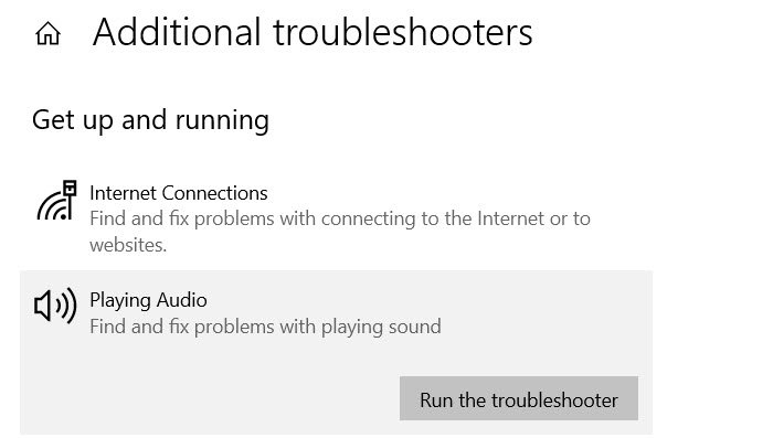

1] Run the Built-In Audio Troubleshooter
Windows built-in troubleshooter can fix most things, and it is always best to run it before any advanced troubleshooting.
Open Windows 11 Settings, and navigate to System > Troubleshoot > Additional troubleshooters > Playing Audio. Select it, and run the audio troubleshooter.
Go to Windows 10 Settings, and navigate to Update and security > Troubleshoot > Additional troubleshooters > Playing Audio.
Run the troubleshooter, and let the wizard do its job—problems such as disabled audio devices, any software block, restarting of services, and so on.

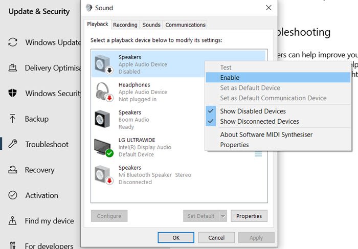

2] Re-Enable Your Audio Device
If you cannot find the device even though it is turned on, it may have been disabled.
- Type Control in the Start menu, and open the classic Control Panel.
- Click on the Sound icon.
- Right-click anywhere on the window, and select Show Disabled Devices
- The list will refresh, and if the device was not listed earlier, you should be able to see it.
- Right-click on it, and choose to enable
You can repeat it for both Playback and Recording.
