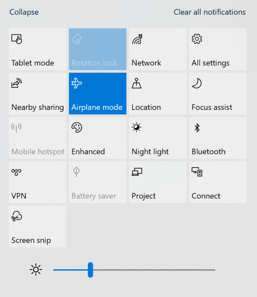

If your Windows Airplane mode constantly keeps turning itself on and off, then this post will help you fix the problem. It can happen after a Windows Feature update or because of Power Management or Network adapter issues.
Airplane Mode puts a device in such a state that all the device’s wireless connections go off. However, some reports tell us that the airplane mode turns on by itself on Windows 11/10. An error with the Network driver, third-party conflicts, and more can cause this. Other errors that come under the same umbrella are when Airplane Mode flickers automatically or when you cannot toggle the Airplane Mode option.
Windows Airplane mode keeps turning On and Off
