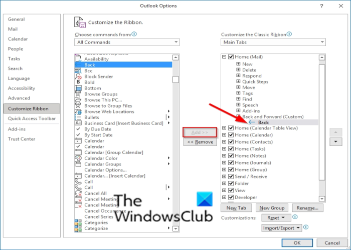

- Right-click the standard toolbar and select customize the ribbon option.
- In the Choose command from the list box, select All Commands.
- Now, search for the Back command button and select it.
- On the right, click the New Group button.

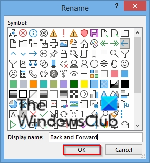

- Click the Rename button to rename the custom group.
- A Rename dialog box will open.
- Rename the custom group and select an icon, then click OK.
- Click the Add button, the Back command will appear under the custom group.

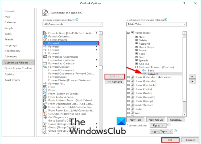

- Now we will add the Forward button.
- Now, search for the Home (mail) tab Forward command button and select it.
- Click the Add button, the Home (mail) tab Forward command will appear under the custom group.
- Then click OK.

Right-click the standard toolbar and select Customize the ribbon option.
In the Choose command from list box, select All Commands.
When searching for a Forward command you will see more than one. In this tutorial, we selected the Forward (Nav Forward) command button.
Click the Add button, the Forward (Nav Forward) command will appear under the custom group.
Then click OK.
