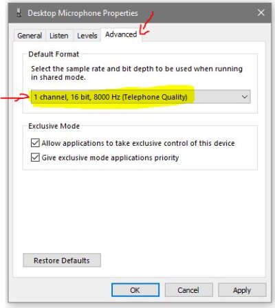

4] Modify sound sample rate and bit depth
You can change your microphone configuration including sound sample rate and bit depth and see if it works for you. This workaround has been proven to be effective for several affected users as reported on the official Microsoft Community page. So, you can try doing the same and see if the issue is resolved.
Follow the below instructions to change the sound sample rate and bit depth for your microphone on Windows 11/10:
- First, press the Win+I hotkey to launch the Settings app.
- Now, go to the System tab and click on the Sound option.
- Next, scroll down toward the bottom of the page and press the More sound settings option.
- After that, navigate to the Recording tab and select the active microphone device.
- Then, click on the Properties button and move to the Advanced tab in the Properties window.
- Now, click on the Default Format drop-down button and choose the 2-channel, 16-bit 48000 Hz (DVD Quality) option. Or, you can play with other sample rates and check what works well for you.
- Finally, press the Apply > OK button to save changes and see if the problem is fixed.
