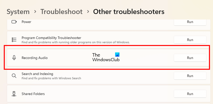

2] Run Recording Audio Troubleshooter
The issue is related to your microphone. Therefore, running the Recording Audio Troubleshooter can help. Go through the following instructions:
- Open Windows 11/10 Settings.
- Go to “System > Troubleshoot > Other troubleshooters.” In Windows 10, you may see Additional troubleshooters instead of Other troubleshooters.
- Locate the Recording Audio Troubleshooter and run it.
If this does not help, check your privacy settings.

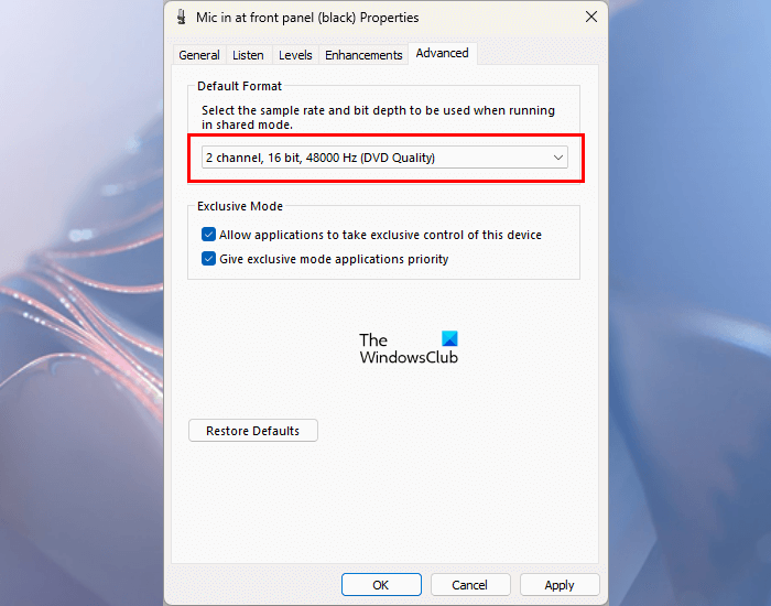

5] Change the default audio channel
Most affected users found that the microphone stops working in the Xbox app when the 1 Channel, 24 bit, 192khz, Studio Quality audio format is selected. Check your default audio format. If you find that the same audio channel is selected for your microphone, select another format. First, open the sound settings box by following the steps explained in the previous fix, and then follow the steps written below:
- Go to the Recording tab.
- Right-click on your default microphone and select Properties.
- Go to the Advanced tab.
- Click on the drop-down under the Default format and select another audio channel.
According to the reports, 2 channel, 16 bit, 48000 Hz (DVD Quality) audio format was found effective in resolving the issue.
