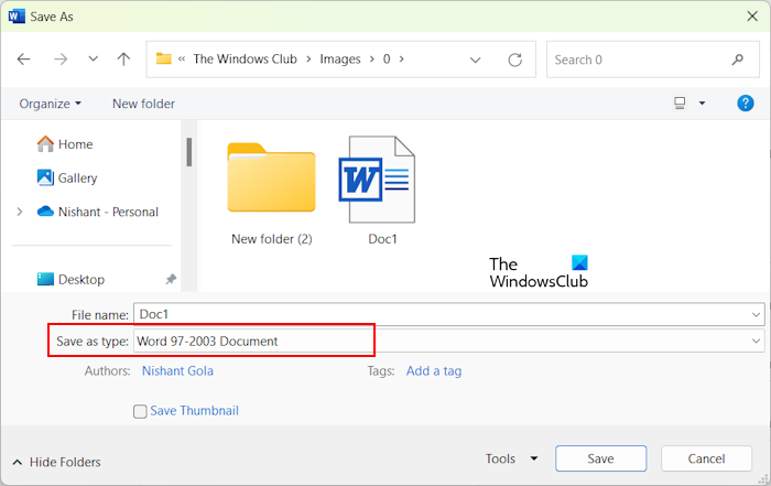

1] Change the Word file format
The first step that you should do is change the Word file format and see if it helps. If you are using a Microsoft Office version higher than 2003, the file format of all Word files is Docx. Try to change it to the old Word format, Doc.
First, close the Word document. Now, copy that file and paste it to another location in your computer, so you can restore it if any problem occurs. Now, open the Word file and then go to File > Save As. Select a location on your computer and then select Word 97-2003 Document in the Save as type drop-down. Click Save. Now, open that Word document and then see if you can export it to PDF.

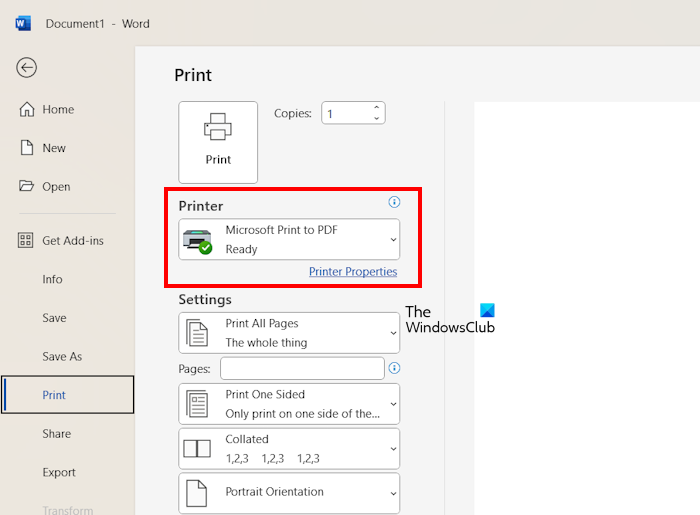

2] Use the Microsoft Print to PDF option
Instead of using the Export feature, you can also use the Microsoft Print to PDF feature to save your Word file as PDF. To do so, open the Word document and go to File > Print. Select Microsoft Print to PDF in the drop-down on the right pane. Now, click on the Print button to save the file as a PDF.
