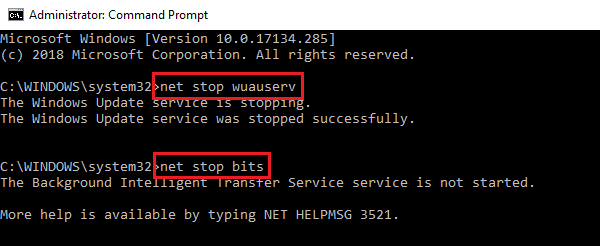

Search for Command Prompt in the Windows search bar and right-click on the option. Select Run as administrator. Type the following commands and press Enter after each of them to execute them:
net stop wuauserv net stop bits
The first command stops the Windows Update Service and the second command stops the Background Intelligence Transfer Service.

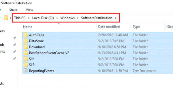

Now open File Explorer and browse to the following path:
C:\Windows\SoftwareDistribution
Here C: is the system drive.
Select all the files in the SoftwareDistribution folder and hit Delete. In case it doesn’t delete all the files, restart the system and try again.

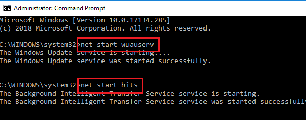

Open an elevated Command Prompt once again as explained earlier. Now type the following commands and press Enter after each command to execute them:
net start wuauserv net start bits
This will restart the Windows Update Service and Background Intelligence Transfer Service, which we stopped earlier.
