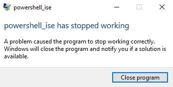

PowerShell_ise has stopped working, A problem caused the program to stop working correctly. Windows will close the program and notify you if a solution is available.
This can be caused by several reasons like an error with the .NET framework, errors in system files, etc.

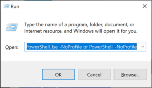

3] Run Windows PowerShell without the default profile
Open the Run box by hitting the WINKEY + R button combinations.
Type in the following inside the text field and hit the Enter button:
PowerShell_Ise -NoProfile or PowerShell -NoProfile
This should launch Windows PowerShell on your computer normally.
