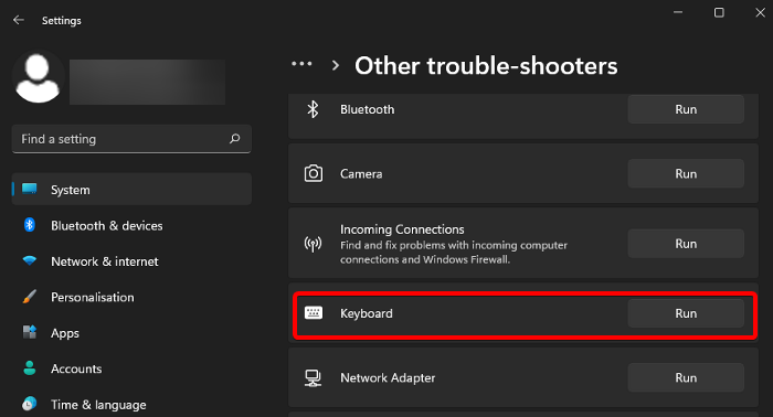

2] Run the Keyboard troubleshooter
Once you have tried all the preliminary methods, but they fail to resolve the issue, you can try running the built-in Keyboard troubleshooter. This can help you detect any issues with the Keyboard and apply the fix automatically.
Open Windows Settings (Win + I) > System > Troubleshoot > Other trouble-shooters > Keyboard > Run.
You could also run the Hardware Troubleshooter.
You can also download and use our useful freeware FixWin to open the troubleshooter with a click.

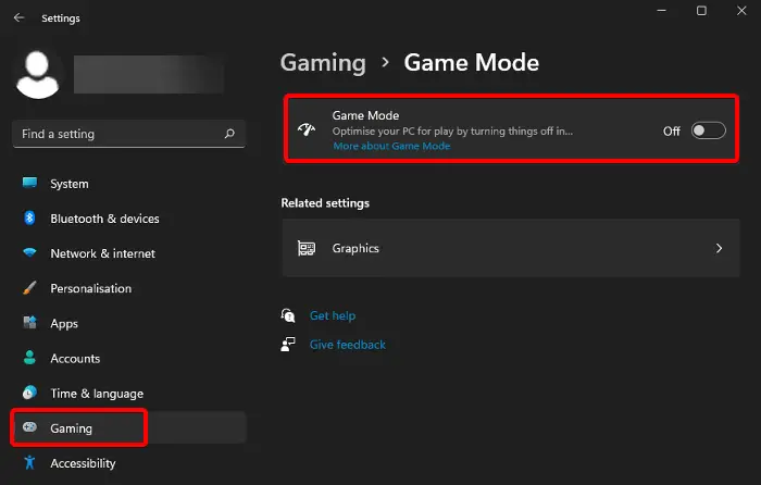

3] Turn off Game Mode
The Game Mode on your PC, when turned on, shuts down any unnecessary tasks or programs running in the background, thus optimizing your gaming experience. But sometimes, this feature can create conflicts with the keyboard, and you may notice that shortcut keys like Windows + P are not working. In this case, it’s advised to disable the Game Mode to fix the issue.

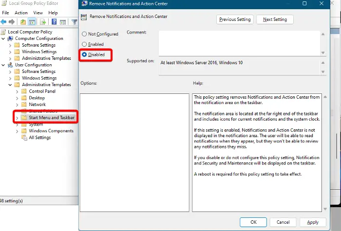

4] Check if the Action Center is enabled
The Win + P shortcut pulls up the Project flyer from the Action Center at the bottom right. Hence, if the Action Center does not open, it can create issues with the shortcut combination. So, you would need to troubleshoot the Action Center first and make sure it’s working.
Also, make sure that the Action Center is enabled in the Group Policy Editor. To do this, open the Local Group Policy Editor, and navigate to the below path:
Configuration > Administrative Template > Start Menu and Taskbar
Now, on the right, look for Remove Notification and Action Center and double-click on it.
In the next window, select Disable, and press Apply and OK to save the changes.

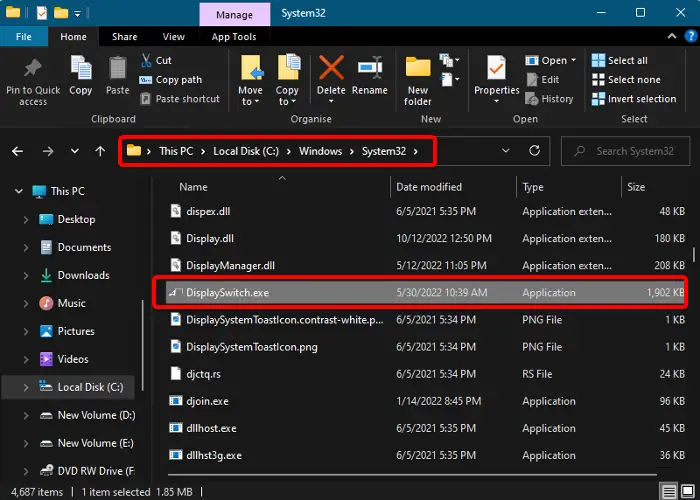

5] Replace the DisplaySwitch.exe file
For some users, replacing the DisplaySwitch.exe file has proven to be effective in resolving the issue if the file has become corrupted.
Run System File Checker to replace this single file or download this file from Microsoft.
Then open the File Explorer, navigate to C:\Windows\System32, look for the DisplaySwitch.exe file, and replace it with the downloaded version.
Never download such files from third-party sources!

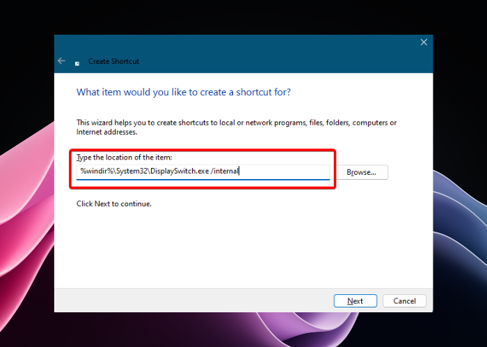

6] Create a desktop shortcut for the Display Switch
If the Win + P keyboard shortcut is still not working, the easiest way to tackle this situation would be to create a desktop shortcut for the Display Switch.
For this, right-click on the Desktop > New > Shortcut. Now, based on your preferred display option, choose the shortcut location as shown below and Type the location of the item in the desired field:
PC screen only
%windir%\System32\DisplaySwitch.exe /internal
Duplicate
%windir%\System32\DisplaySwitch.exe /clone
Extend
%windir%\System32\DisplaySwitch.exe /extend
Second screen only
%windir%\System32\DisplaySwitch.exe /external
Once you have entered the location of the item, press Next. Now, name the shortcut, preferably, Display Switch, and click on Finish. Once done, you can now use the desktop shortcut instead of the Win + P key shortcut on the keyboard.
