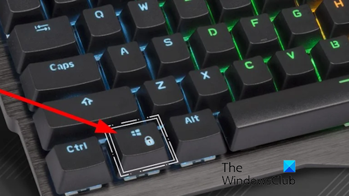

2] Unlock the Win key or press the Fn+Win key
If you have a gaming keyboard, it will likely have a Lock button to disable the Windows key. Look for the Win Lock button on your keyboard and press it to unlock the Windows key.
Some affected users have also reported that pressing the Function (Fn) key with the Windows key worked for them. So, you can try doing the same and see if it helps you enable Windows key in games.

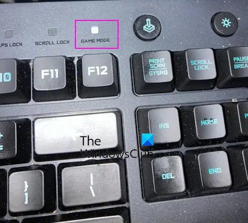

3] Disable the gaming mode
This issue can often occur if your computer’s gaming mode is enabled. The Game Mode feature is handy but often triggers conflicts with your keyboard’s regular functioning. It also disables the Windows and Menu key functions to avoid accidental usage.
You can find the Gaming Mode button on your keyboard and press it to disable the feature. For some gaming keyboards, you might have to press a combination of keys to disable or enable the game mode. If you have a Razor keyboard, press the Fn+F10 key combination to enable/disable gaming mode. If you own a Logitech gaming keyboard, you can use Fn+F8 hotkey to disable game mode. For the Alienware gaming keyboard, you can press Fn+F6 to enable/disable game mode. Similarly, you can disable game mode on other keyboards to get the Windows key working correctly in games.

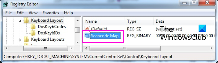

7] Enable Windows Key using this registry tweak
You can enable the Windows key using Registry Editor. First, create a backup of your Registry to be able to restore it in case of a wrong modification.
Now, open the Registry Editor and move to the following key:
Computer\HKEY_LOCAL_MACHINE\SYSTEM\CurrentControlSet\Control\Keyboard Layout
From the right-side pane, select the Scancode Map registry entry, press the Delete button, and press Yes on the confirmation prompt. This will reset all your keys to their regular functions if remapped.
Once done, close Registry Editor and restart your PC to check if the issue is resolved.
