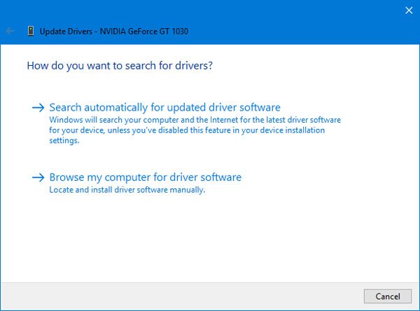

Right-click on that driver and select Update Driver. You should get a window like this:

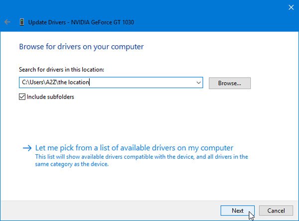

Select the Browse my computer for driver software. Now click the Browse button and select the driver path. This is of course if you already have the driver file or have downloaded the driver setup file from the manufactures website.
Hit Next to start the find and installation process. It should fix the problem within moments.
If you do not have the driver setup file, then in the Location field, use the following path:
C:\Windows\WinSxS
The WinSxS folder, stores multiple copies of dll, exe and other system files in order to let multiple applications run in Windows without any compatibility problem. If you browse inside, you will see what looks like a lot of duplicate files, each having the same name. These are actually, different versions of the same files which are being stored; as different programs may require different versions.
Windows will search for the driver in the WinSxS folder and install it. This should help.
