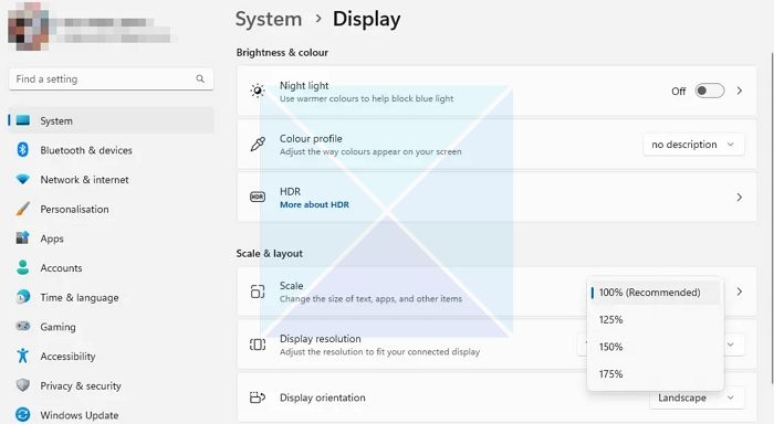

1] Configure the Scaling of Your Monitor
This issue usually occurs when you use two displays with different scaling settings. For example, if your primary display is set with 100 % scaling, but the secondary display is at 125%, it will break.
Undoubtedly incorrect scaling settings of the display are the prime cause of the Snip and Sketch tool’s failure to capture the whole screen. Ideally, both displays should be on the same scaling settings. The error usually happens when the scaling settings of both displays vary. Now follow the below steps to configure the scaling of your monitor.
- Press the Win+I keys together to open the Settings option.
- Navigate to System> Display option
- Now, you will get the Scale settings from the right side panel under the Scale and Layout.
- Extend the dropdown menu under it, select whatever percentage you want for both displays, and reboot the System to make the changes.
Make sure to check if the issue is resolved after this.
