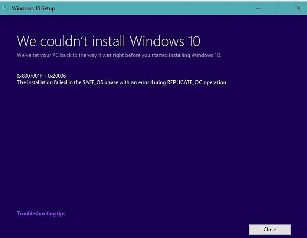

Microsoft’s Windows Media Creation tool is a valuable tool to get your computer to download and install the latest version of the Windows 11/10 operating system. However, during setup, it has been known to give the following error message:
0x8007001F-0x20006, The installation failed in the SAFE_OS phase with an error during REPLICATE_OC operation.
Safe OS phase: this phase is initiated to install all the required updates. The possible causes for this could be an interrupted download, the internet connection, etc.
Windows 11 installation failed, error 0x8007001f – 0x20006
We will be taking a look at the following suggestions to resolve the error code 0x8007001f – 0x20006 for the Windows 11/10 Upgrade:
