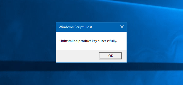

To uninstall the existing key, enter:
slmgr.vbs /upk

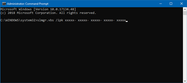

To install the KMS Product Key, enter:
slmgr.vbs /ipk <The KMS Product Key>
Once done, you will get a prompt whether the operation was either successful or not.
To activate it online, type:
slmgr.vbs /ato
To activate it using the telephone, type:
slui.exe 4
After activating the KMS key, restart the Software Protection Service.
You can then also verify the Activation Status to check if your fix was successful or not.
