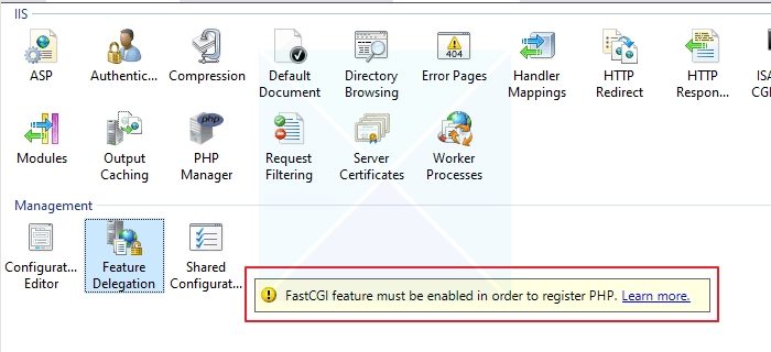

If you have enabled CGI/FastCGI using the Windows Features Experience, and even then, if you notice no CGI icon in IIS Manager, this post will help you fix the problem. You can also identify the issue when you check with the PHP manager and notice a message saying – FastCGI feature must be enabled in order to register PHP.
