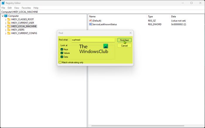

But it appears that the location above is very specific and probably doesn’t apply to everyone. So, if it doesn’t work for you, then you can follow the step-by-step instructions below to search the Windows registry to find the location of the particular game you want. For this post, we will use the Cuphead game as an example.
- Open the Registry Editor.
- In the Registry Editor, press Ctrl+F or click the Edit tab, then click Find.
- In the search box popup, type cuphead into the Find what field.
- Click the Find Next button or hit Enter to start the search. Leave the Keys, Values, and Data, checkboxes checked and the Match whole string only checkbox unchecked.
- When the registry search completes, some registry files with the word “cuphead” are shown and highlighted for every file it’s referencing.
- The registry file you are looking for is called PackageRootFolder and you should see your file location for the game in the data column. In case, you don’t see this particular registry file, perform the search again. You may have to do this a couple of times.
- Once found, double-click the PackageRootFolder registry file to open its properties.
- Now, press Ctrl+C to copy the already highlighted location data to the clipboard.
- Exit Registry Editor.
