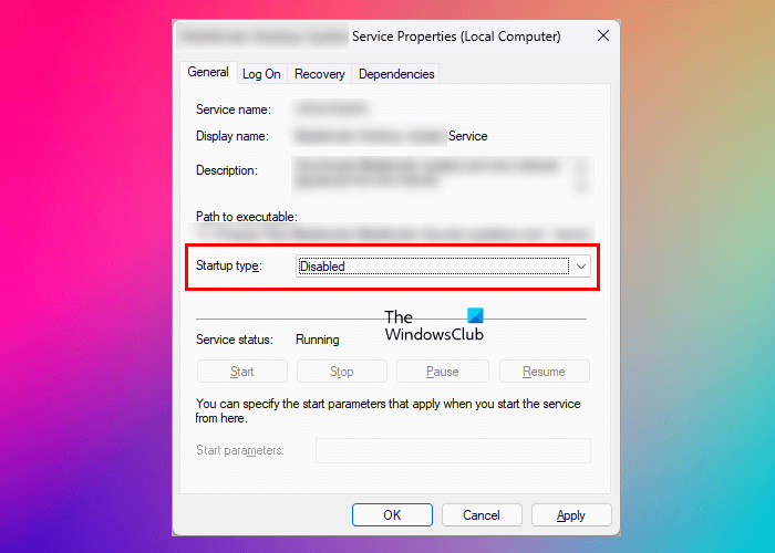

Some users stated that the SmartByte app gets installed by itself every time they restart their systems. In such a case, you can disable the SmartByteTelemetry process permanently. To do so, you have to use Windows Services Manager. Follow the steps written below:
- Click on Windows Search and type services.
- Select the Services app from the Search Results.
- In the Services app, look for the SmartByteTelemetry service or the service that represents the SmartByte app (it should have a name identical to the SmartByte app).
- If you find it, right-click on it and select Properties.
- In the Properties window, make sure that you are under the General tab.
- Select Disabled in the Startup type.
