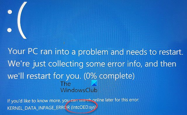

Are you experiencing a blue screen or random crashes with the What Failed: ‘IntcOED.sys’ error code on your Windows 11 or Windows 10 computer? Some users have encountered a blue screen accompanied by the What Failed: ‘IntcOED.sys’ error code. This is the blue screen error that occurs while Windows installs a collective update or while installing the remaining drivers. It is also known as a fatal error as the OS stops working.
If you are one of the affected users, you have landed on the correct page. Here, we have mentioned the solutions that helped affected users to get rid of the error. You try these fixes and resolve the error without much trouble.
What is IntcOED.sys?
IntcOED.sys is an error on Windows that causes a blue screen to appear. The majority of the users reported that the main culprit behind this problem is inconsistency with Intel’s SST or Smart Sound Technology. However, other factors can also lead to the development of the IntcOED.sys error code.

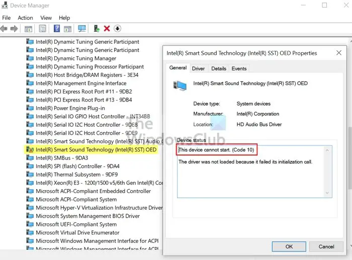

1] Uninstall or Reinstall Intel’s Smart Sound Technology (SST)
One of the simplest ways to fix the IntcOED.The ” sys failed” error on Windows is due to uninstalling SST or Intel Smart Sound Technology. After that, you can reinstall it if you want. However, users report that reinstalling SST might not fix the issue. For the best results, keep SST uninstalled to get rid of the blue screens.
Check out the steps you must adopt to uninstall SST
- Press Windows and R keys simultaneously to open the Run dialog box.
- Type devmgmt.msc and press Enter. It will open the Device Manager that offers admin access.
- Here, you need to look out for Sound, Video, and Game Controllers in the list of device categories.
- Expand the category and locate Smart Sound Technology OED.
- Right-click on Smart Sound Technology OED. From the context menu, select Uninstall Device option.
- You will get a pop-up message that asks if you are sure you want to uninstall the device, press Yes.
- Now, you need to wait until the uninstallation occurs.
- Restart the PC.
After that, check if the IntcOED.sys failed error still occurs.

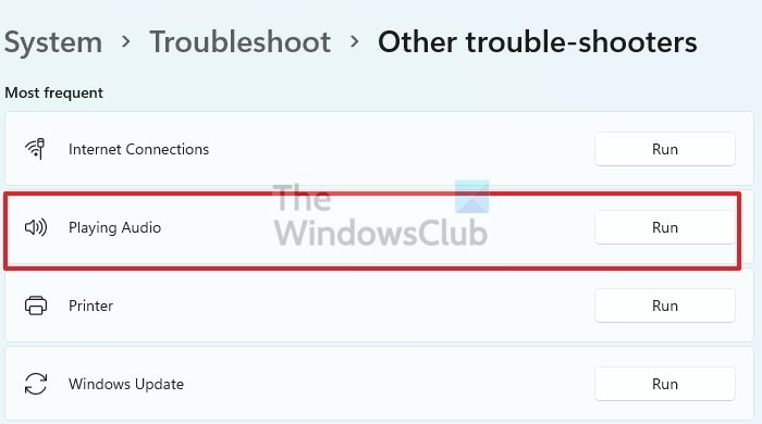

2] Run Playing Audio Troubleshooter
Often, the cause of IntcOED.sys failed error is an improperly ported sound driver from Windows. In that case, Microsoft has proposed a fix you can apply. Here are the steps that you need to follow to run the Audio Troubleshooter –
- Click on the Windows icon (extreme left bottom corner of the screen). From here, you need to open Settings.
- Click on the System
- Select Troubleshoot on the left pane from the list of options, followed by Other Troubleshooters from the right-hand side settings.
- Select Playing Audio. Click on Run the Troubleshooter from the drop-down.
- It would help if you waited as Windows will scan the system for audio-related issues.
- If everything is fine, you have to look out for other solutions.
- However, you will get a pop-up message with instructions if there is an issue.
- Click on Yes, Open Audio Enhancements.
After that, restart the system and check if the problem is fixed.

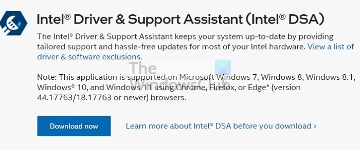

3] Update Drivers Using Intel Assistant Software
Sometimes, issues with the driver that comes with the Microsoft update can cause the IntcOED.sys failed error. In that case, you can visit the Intel Driver page and use the Intel Driver & Support Assistant software to update the drivers.
- To start with, you need to click on Download Now button to download the software.
- Follow the on-screen instructions to install the software.
- Once the software is installed, please open it and run the Support Assistant.
- It will automatically detect the software to update and install. Follow the on-screen instructions.
This suggestion is likely to help you.
Related: Intel Driver & Support Assistant is not working
