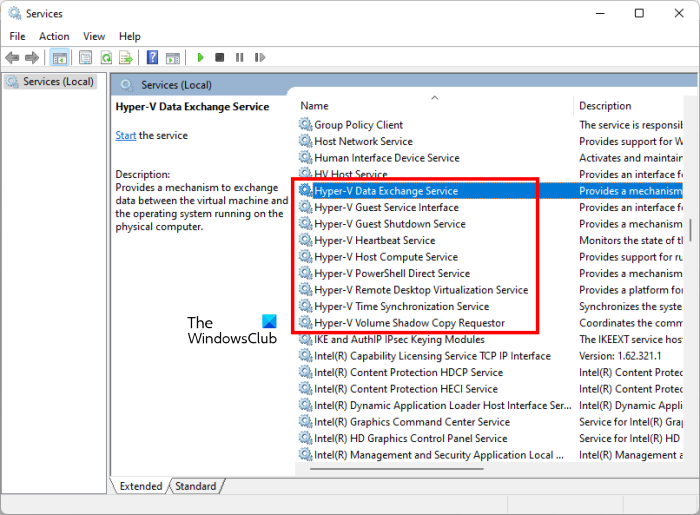

If VMware still refuses to start and shows you the same error message, there might be some Hyper-V-related services running on your system. Check this in the Windows Services Manager and stop the running Hyper-V services. Follow the steps written below:
- Open the Run command box.
- Type services.msc and click OK.
- In the Services Manager app, scroll down and locate all Hyper-V services.
- Stop all the Hyper-V services one by one. For this, right-click on them and select Stop.
The services set to Automatic start automatically on system startup. If the startup type of any Hyper-V service is set to Automatic, change it to Manual so that the service could not start by itself when you start your system. For this, right-click on the Hyper-V service, the status of which is Automatic and select Properties. Under the General tab, select Manual in the Startup type drop-down. Click Apply and then Click OK.
After performing the above steps, restart your computer.

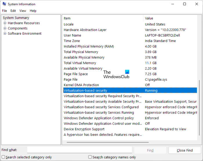

One possible cause of the problem is VBS technology. If Virtualization-based Security is enabled on your Windows host machine, you will not be able to run VMware Workstation Pro. To check if VBS is enabled on your system or not, follow the steps mentioned below:
- Click on Windows Search and type System Information.
- Select System Information from the search results.
- In the System Information, select System Summary from the left side.
- Scroll down on the right side and see the status of the Virtualization-based Security.

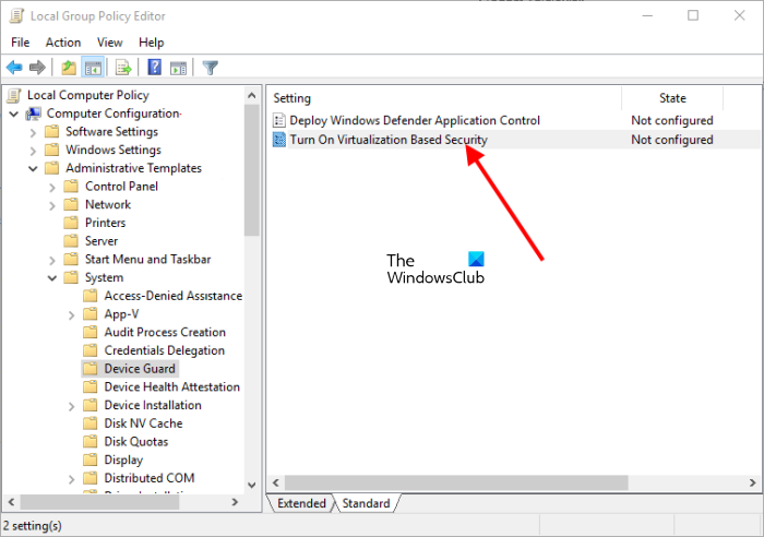

If the VBS technology is running, you have to disable it. To do this go through the following instructions:
- Open the Run command box and type gpedit.msc. Click OK. This will open the Local Group Policy Editor.
- Expand the Computer Configuration branch on the left side.
- Go to “Administrative Templates > System > Device Guard.”
- Double-click on the Virtualization Based Technology on the right side.
- Select Disabled.
- Restart your system.

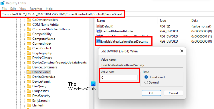

If you have the Home edition, you do not have the Local Group Policy Editor. Hence, you can disable Virtualization-based Security (VBS) via the Registry Editor. Windows Registry is the hierarchical database of the Windows OS. Any mistake while modifying the Registry can cause serious errors in your system. Therefore, before you begin, we recommend you create a System Restore Point and back up your Registry.
Open the Run command box and type regedit. Click OK and click Yes in the UAC prompt. This action will open the Registry Editor.
Copy the following path, paste it into the address bar of your Registry Editor, and hit Enter.
Computer\HKEY_LOCAL_MACHINE\SYSTEM\CurrentControlSet\Control\DeviceGuard
Make sure that the DeviceGuard subkey is selected on the left side. Check if the EnableVirtualizationBasedSecurity Value is available on the right side. If not, create it manually by following the steps written below:
- Right-click on the empty space on the right side.
- Go to “New > DWORD (32-bit) Value.”
- Right-click on the newly created Value and select Rename.
- Name it EnableVirtualizationBasedSecurity.
Right-click on the EnableVirtualizationBasedSecurity Value and select Modify. Its Value Data should show 0. If not, enter 0 in its Value Data and click OK.

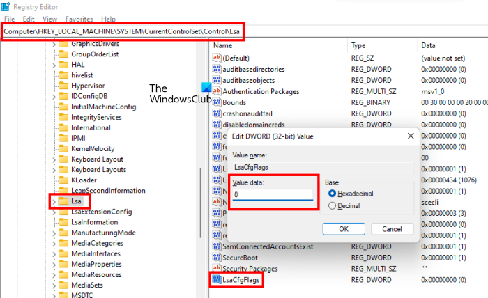

Now, copy the following path, paste it into the address bar of the Registry Editor, and press Enter.
Computer\HKEY_LOCAL_MACHINE\SYSTEM\CurrentControlSet\Control\Lsa
Make sure that the Lsa subkey is selected on the left side. Now, check if the LsaCfgFlags Value exists on the right side. If not, create a DWORD (32-bit) Value manually by following the steps explained above and rename this Value as LsaCfgFlags.
The Value Data of LsaCfgFlags should show 0. Right-click on it and select Modify to check what its Value Data shows. If 0 is not there, change its Value Data to 0 and click OK. Close the Registry Editor and restart your computer.
This should work.
