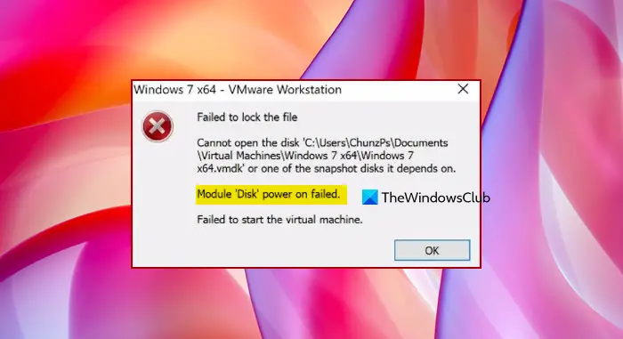

Some users have been complaining that VMWare apps have been showing the following error message when trying to open a Virtual Machine.
Failed to lock the file
Cannot open the disk ‘C:\Users\<username>\Documents Virtual Machines Windows.vmdk’ or one of the snapshot disks it depends on.
Module ‘Disk’ power on failed.
Failed to start the virtual machine.

Before fixing the problem, we need to know what it is and what’s causing it. The problem is, some of the VMware files are blocking your VM. Which is, needless to say, won’t let you play the game. But the question is, why is it blocking the Virtual Machine? To fathom this, we need to understand the mechanism behind VMWare.
When you open a Virtual Machine, some files are there to control the functioning of your machine. The files with the extension .lck are created as soon as the machine is turned on, and they make sure that multiple VMs can’t read or write to the disk.
Lock files are deleted instantly when you close the VM. This is done to ensure that it doesn’t interfere with any other service. However, in the event of an improper shutdown or crash, these files are left undeleted on your system, which can cause the issue in question.

1] Delete Lock folders
As mentioned earlier, the workstation creates a Lock folder which is meant to be deleted as soon as you turn off your Virtual Machine. However, sometimes, you have to delete it manually. We are going to see how to delete Lock or .ilk folders manually. Follow the given steps to do the same.
- Power off your VM.
- Now, we need to go to your directory. If you know the path, just go there, if you don’t know, right-click on your VM and click Open VM directory. You will be redirected to a location in Windows File Explorer.
- Then delete folders with .lck folders.
Finally, restart your computer and check if the issue persists.
