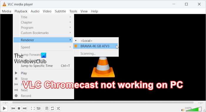

To cast videos from Windows to Chromecast using VLC, follow the below steps:
- Open the media player app and go to the Playback menu.
- Navigate to the Renderer option and you will be able to see a list of detected Chromecast devices.
- Select the desired Chromecast to which you want to play a video.
- Open a video or audio and it will start playing on your TV.

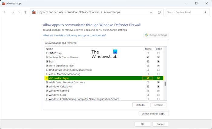

3] Allow VLC through your firewall
Another potential cause of this issue could be interference by your firewall. To confirm the same, disable your firewall for some time and then see if you can cast videos from your PC to Chromecast using VLC. If yes, you can fix the issue by allowing the app through your firewall. Here’s how:
- First, open the Windows Security app using Windows Search and click on Firewall and Network Protection.
- After that, select the Allow an app through firewall option.
- Next, press the Change Settings button.
- Now, locate the VLC media player app in the list and tick the checkbox associated with it.
- After that, tick the Public and Private network checkboxes present next to the app and click on the OK button to save changes.
- Finally, open VLC and check if the problem is resolved.
