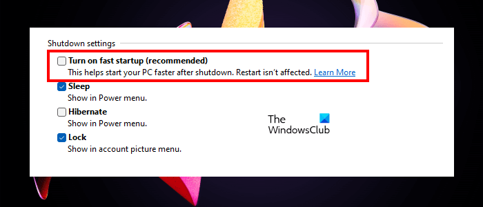

9] Turn off Fast Startup
Some users have reported that Fast Startup caused the issue. When they disabled Fast Startup, the issue was fixed. We also suggest you disable Fast Startup. Maybe it will work for you too.
