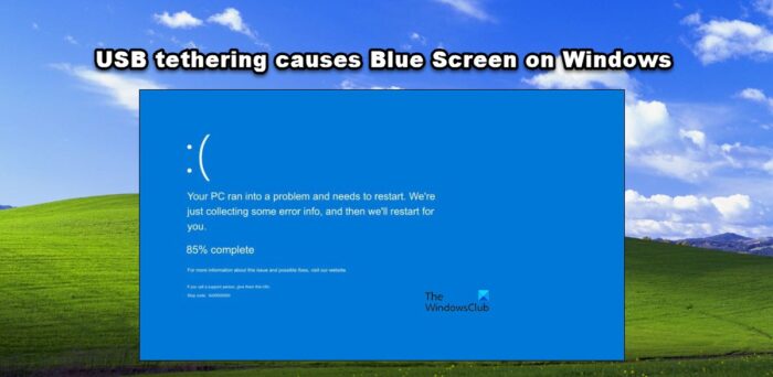

One of the earliest ways to use your mobile Internet on your computer is by connecting both devices via a USB cable with USB tethering enabled. When some users tried to do the same, they get a Blue Screen. In this post, we will talk about this issue and see what you can do if USB tethering causes a Blue Screen on Windows 11/10.
Your PC ran into a problem and needs to restart. We’re just collecting some error info, and then we’ll restart for you.

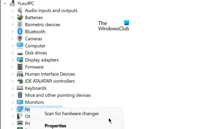

- After uninstalling the driver, you need to disconnect and reconnect the device, the driver should be installed automatically. Alternatively, you can right-click on the Network adapter and select Scan for hardware changes to install the driver.

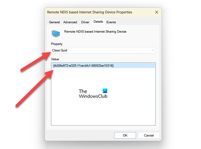

Before that, we need to find the GUID of the USB tethering driver. To do the same, open Device Manager, expand Network adapters, right-click on the USB tethering driver, select Properties, go to Details, change Property to Class GUID, and copy the string (right-click on it and select Copy).
