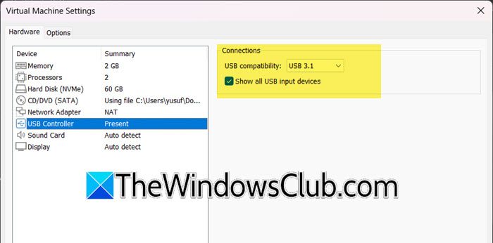

- Close the VM properly, go to the VM Menu, click Manage, and select Settings.
- Go to the Hardware section, click on the Add button to choose USB Controller, select USB Controller, and press the Finish button.
- Click the USB controller tab from the list, and select Show all USB input devices.
- Enable the correct USB compatibility: USB 3.1 or USB 2.0 and press the Ok button.
- Click the OK button, play the virtual machine, access the Player menu, and check whether the USB device is now visible in the Removable Device menu or not.

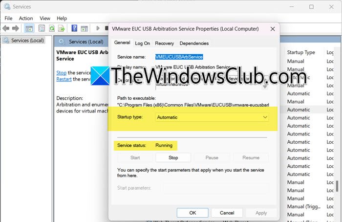

The VMware USB Arbitration service plays a crucial role by detecting USB devices connected to the host system and making them available for virtual machines. To address the issue, we will configure this service. To do so, execute the steps outlined below:
- Click Win + R to open the Run Dialog box, type services.msc, and click OK to open Services.
- In the Services window, find VMware EUC USB Arbitration Service, and right-click on it.
- Select Properties, navigate to the Startup type drop-down menu, set it to Automatic mode, and ensure that it is indicating Running in the Service Status.
- If it is not showing running, click on the Start button, and click the OK button.
Once done, refresh the OS, and then check if the issue persists. If it does, move on to the next solution.

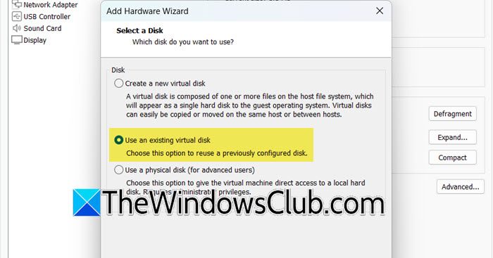

- Once you have created the virtual machine, right-click on it, select Settings, go to Hard Disk, select the Add button, and click the Next button.
- Keep all the options as default until you are on the screen to select the hard disk, click Use an existing virtual disk, and then hit the Next button.
- Select Browse, navigate to the location of the existing VM, select the VMDK file, and click Open.
- Once done, click on the Finish button, and then launch the virtual machine.
