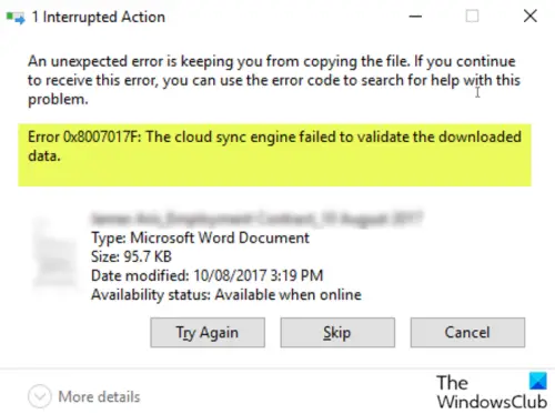

Some PC users are reporting that after they have enabled the OneDrive Files On-Demand feature, intermittently, when they try to open files from SharePoint or import/download any file to their Windows 11/10 device, they receive the message Error 0x8007017F, The cloud sync engine failed to validate the downloaded data. This post offers the most suitable solutions to this OneDrive error.
Affected users further reported that PDFs seem to open, but Office documents throw the error with the TRY AGAIN, SKIP, or CANCEL option. However, clicking the TRY AGAIN button multiple times (2-10) ultimately opens the file; this is not ideal since it’s more of a workaround than a solution. So, if you need a permanent fix, continue with the post below.
OneDrive Error 0x8007017F: The cloud sync engine failed to validate the downloaded data
Clearly, something is failing between the Windows OS and the CLOUD validation/hand-off process when retrieving from the CLOUD.
So, if you’re faced with this issue, you can try our recommended solutions below in no particular order and see if that helps to resolve the issue.

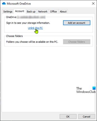

3] Unlink and relink the OneDrive account
Do the following:
- Right-click on the OneDrive icon (if not present, click the chevron to see hidden icons) in the notification area/system tray and select Settings from the menu.
- Select the Account tab.
- Click on the Unlink this PC button.
- Next, sign in with your credentials.
- Select the location of the OneDrive folder to relink your account.
