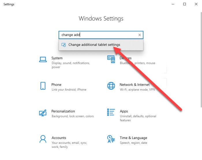

1] Change additional tablet settings (Windows 10 only)
OK, so the first thing you will want to do here, is to fire up the Windows 10 Settings area, then from the search box, type Change additional tablet settings.
After that, go to When I’m not using tablet mode > Make app icons on the taskbar easier to touch and turn it off.
Finally, restart your computer and attempt to do what you were doing before. We are confident the spacing on the taskbar should now be fixed.

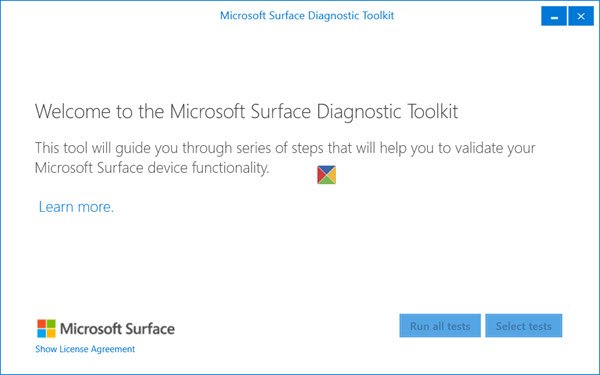

3] Run the Surface Diagnostic Tool
Most common issues on Surface can be solved by running the Surface Diagnostic Tool. Run it and see.
