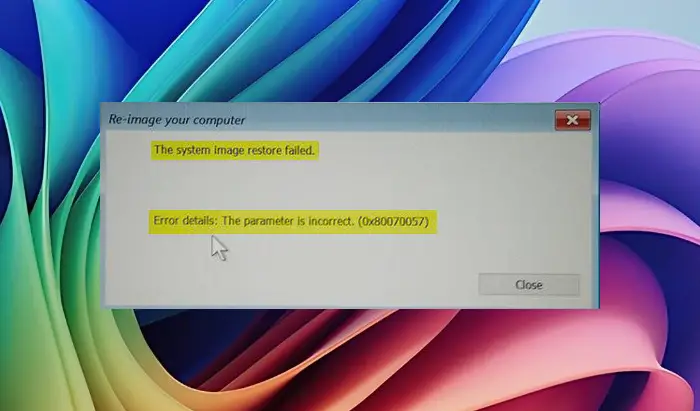

When you try to restore a Windows System Image and the operating fails, you may see an error message – The system image restore failed. The cause could be mentioned:
The parameter is incorrect (0x80070057)

The system image restore failed – 0x80070057
![The system image restore failed, Error 0x80070057 [Fix]](https://www.thewindowsclub.com/wp-content/uploads/2020/02/The-system-image-restore-failed-Error-0x80070057-1.png)
If you see The system image restore failed, The parameter is incorrect (0x80070057) error on your Windows 11/10 computer, follow these suggestions.
Restart your Windows computer to boot into Advanced options and select Command Prompt, and execute the following commands one after the other:
diskpart
list disk
sel disk x
clean
exit
In the sel disk command, you have to replace ‘x’ with the relevant disk number to which the image restore is being done.
Close Command Prompt and restart your device.
Now again go to Advanced Options, and select System Image Recovery and try to restore the System Image and see if it helps.
