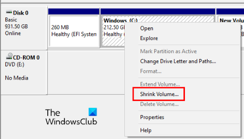

2] Shrink the source partition
If the destination drive has less space than the original drive (the drive from which you created the image), you can try shrinking the source partition to a size less than the destination drive and then creating its image. Now, use this image file to restore Windows. If you are restoring the image on an SSD, try cloning the shrunk partition to the SSD.
The steps to shrink the drive are given below:
- Type Disk Management in the Windows search bar and click on the app to launch it.
- Right-click on the drive and select Shrink Volume.
- Enter the amount of space to shrink and click on the Shrink button.
