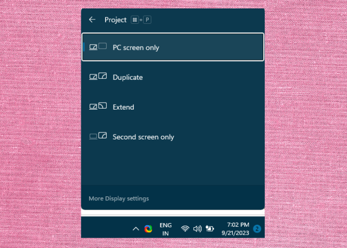

2] Set a proper project mode
To extend your Surface display through the dock to the external monitor, press the Win + P shortcut to open the Project to screen mode. This will help you select the correct external display. You can now choose a way to project.
- If you want Surface to be the primary display – Select PC screen only.
- If you want to see both on your Surface and on the external monitor – Select Duplicate.
- If you want to drag and move what’s on your Surface to the monitor – Select Extend.
- If you want to see everything on the monitor and the Surface device will be blank – Select External display only/Second screen only.
- If you want to connect to compatible monitors via Miracast – Select Connect to a wireless display.

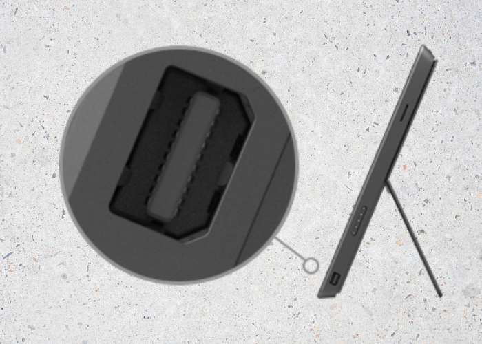

- Ensure that the video connection from the USB-C port or Mini DisplayPort on your Surface device, dock, or any other video adapter you are using, and the input connection on your monitor is all secure.

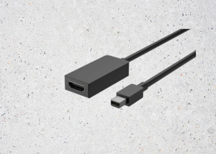

4] Check if the display adapter is connected properly
For those using adapters like a USB-C to HDMI Adapter, USB-C to DisplayPort Adapter, or USB-C to VGA Adapter, disconnect and reconnect the adapter firmly to the Surface docking station.
But if the external display doesn’t support DisplayPort or USB-C, you may use HDMI. Otherwise, you may use a DVI or VGA cable.

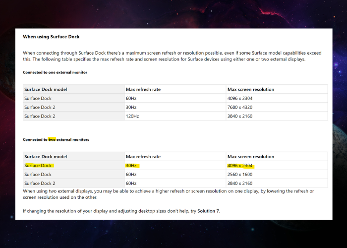

5] Adjust the supported resolution and refresh rates
If you are trying to connect your Surface Dock to an external monitor, the display can reach a maximum refresh rate or resolution. The data shown below indicates the maximum refresh rate and display resolution for Surface devices that are using a single or two external monitors:
When connecting to a single monitor:
Surface Dock model |
Max refresh rate |
Max display resolution |
| Surface Dock | 60 Hz |
4096 x 2304 |
Surface Dock 2 |
30 Hz |
7680 x 4320 |
Surface Dock 2 |
120 Hz |
3840 x 2160 |
Surface Thunderbolt™ 4 Dock |
60 Hz |
3840 x 2160 (USB4/Thunderbolt™ 4)* |
60 Hz (8 bit color) |
3840 x 2160 (USB-C, DisplayPort 1.3 or later – HBR3)* |
30 Hz (10 bit color) |
3840 x 2160 (USB-C, DisplayPort 1.2 or later – HBR2)* |
When connecting two monitors:
Max refresh rate |
Surface Dock |
30 Hz |
4096 x 2304 |
Surface Dock |
60 Hz |
2560 x 1600 |
Surface Dock 2 |
60Hz |
3840 x 2160 |
60 Hz |
*Data courtesy – Microsoft

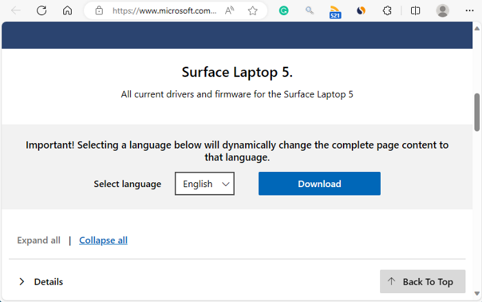

7] Update Surface Dock Firmware
It could be possible that the firmware of the Surface Dock does not support the monitor or the accessories (cable/adapter). Therefore, it’s recommended to visit the Surface Support website and update the Surface firmware to the latest version to avoid such issues.

To connect the Surface Dock to your monitor, firstly, you need to connect your USB computer attachments to the USB ports of your docking station. Then, connect the video cable of your monitor to the Mini DisplayPort and make sure it’s compatible. But, if the monitor cable doesn’t have a Mini DisplayPort connector, you would need to invest in a compatible adapter or cable.
