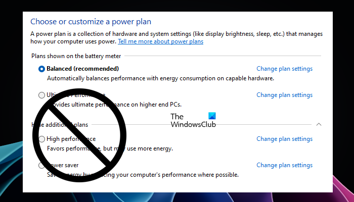

In this article, we will show you how to specify a custom active power plan and force Windows 11/10 to use it. We all use different kinds of power plans on our system according to our requirements. When we’re going to watch movies or play games on our system, we choose the High-Performance power plan, and when we save battery for long use, we use Power Saver.
If you consider a multi-user system, there may exist a scenario when you select a power plan that you find useful, and in your absence, someone else who used the system changed the power plan which you find destructive. In such a case, placing a restriction to modify the power plans by others on your system became necessary.
Force Windows to use Specific Power Plan
On a shared computer, if someone keeps changing the previously selected power plan every time he uses your computer, it becomes irritating for you because you have to rever the power plan settings every time you turn on your computer. Hence, it is a good idea to restrict users from changing the power plan. In this article, we’ll show you the way to specify a custom active power plan and force Windows 11/10 to use a specific power scheme so that users can’t modify the active power plan from normal settings.

In the right pane of the window shown above, double click Specify a custom active power plan setting that is Not Configured by default to get this:
In the above-shown window, firstly click Enabled, and then in the Options section, input the Custom Active Power Plan (GUID) as we showed you in the Administrator Command Prompt earlier in this article. Click Apply, followed by OK. You may close the Local Group Policy Editor now.
Now if you try to set power schemes manually by clicking the battery icon in the taskbar notification area, you won’t be able to do so:
