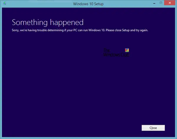

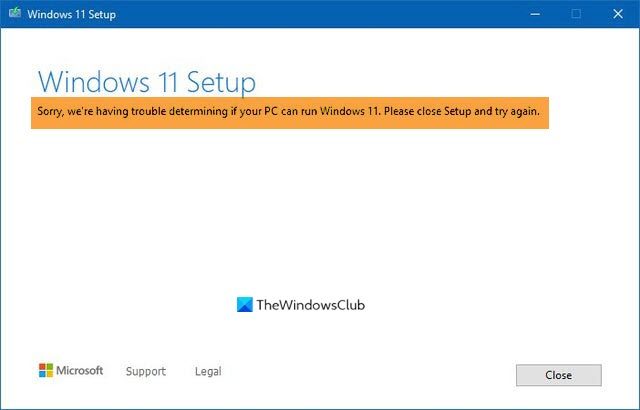

Some Windows users get to see Sorry, we’re having trouble determining if your PC can run Windows 11/10 error message while trying to upgrade their PC to Windows 11 or Windows 10. If you are trying to install Windows 11/10 but seeing this error message, here’s what you need to know. The error message may appear on your PC when you run the compatibility test before upgrading from an older version of Windows to Windows 11/10. Here is why the problem appears and how you can solve it.
Something happened. Sorry, we’re having trouble determining if your PC can run Windows 11/10. Please close Setup and try again.

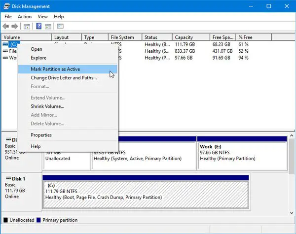

3] Mark Partition as Active
As you are getting this error message while upgrading from an older version of Windows to Windows 11/10, chances are you have already marked the system drive as “Active.” Windows makes the C drive active by default so that the system files load properly. However, if you have done changes in your system and made the C drive as inactive by mistake, you can find this error while upgrading. There is an effortless way to verify if your system drive is marked as active or not.
- Type diskmgmt.msc and hit the Enter button. It should open the Disk Management window on your screen.
- Right-click on the system drive where your current operating system is installed and select Mark Partition as Active.
Please note that the screenshot is captured on Windows 10 but the interface looks the same on Windows 11.
Now try to run the Setup.exe file. You should not get any problem passing the compatibility test.
