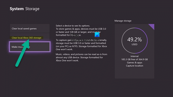

3] Clear local Xbox 360 storage (for Xbox One)
The error in view can also occur due to some kind of file corruption inside your Local360 Storage folder. This is a hidden folder and can be accessed after you try to launch the backward-compatible game on your Xbox One.
To delete the local Xbox 360 storage on your Xbox One console, do the following:
- Press the Xbox button to open the guide.
- Navigate to the rightmost menu and click on the Settings icon.
- Next, navigate to System > Storage to open System Storage.
- In System Storage menu, select the Clear local Xbox 360 Storage option.
- Follow the prompts to complete the procedure.
- Restart console when done.
After the console reboots, you can try to play the backward-compatible game again and see if the issue is now resolved. Otherwise, try the next solution.
