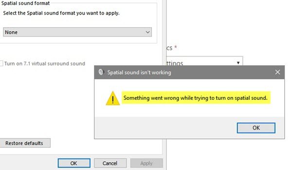

If your Windows computer supports Dolby Atmos, and you want to use it on the Home Theater, a few settings have to be changed. However, if you get an error Spatial sound isn’t working, Something went wrong while trying to turn on Spatial Sound, we will help you to fix this solution.
Just before we go ahead with the solution, you will need to have the latest Dolby Atmos installed on your computer. Once installed, you will have to choose Dolby Atmos for your headphones or home theater from the options. This is where the problem occurs.
Something went wrong while trying to turn on Spatial Sound error in Windows 11
There are multiple scenarios where it may happen.
- When you select “Dolby Atmos for Home Theater”, you will receive the error “Something went wrong while trying to turn on spatial sounds”. Post this, the settings will revert back to “off”.
- You connect to the Soundbar using an HDMI cable from PC to screen. You get the same error as above when you switch, but when you choose Headphones, it works just fine. This happens even when you have the wiring correct, i.e., the HDMI is connected on the PC to the soundbar, then the soundbar connected to the HDMI screen.
