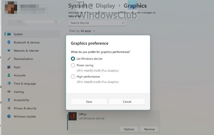

4] Adjust graphics settings for your apps and games
The issue might be caused if you have a medium or low-end GPU but your graphics settings are set to high performance. On the other hand, it might be the case that your GPU cannot perform to its best capabilities due to incorrect graphics settings. Hence, you can modify your graphics settings for problematic apps and games to fix the issue. To do that, use the below steps:
- First, open Settings using Win+I and move to the System > Display tab.
- Now, click on the Graphics option below Related settings.
- Next, select the app or game with which you are facing this issue. You can manually add it by clicking on the Browse button.
- After that, press Options and then choose an appropriate option between Let Windows decide and High performance.
- Finally, press the Save button and check if the problem is fixed.
