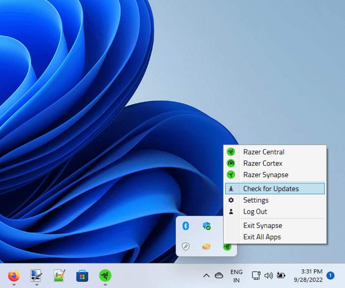

1] Check for updates manually
We suggest you check for updates manually. If you are using the outdated version of Razer Synapse, the problem should get fixed after updating the app. The following instructions will guide you on this:
- Launch Razer Synapse.
- After getting launched, it should appear in the System Tray.
- Click on the System Tray and right-click on the Razer Synapse icon.
- Click Check for Updates.

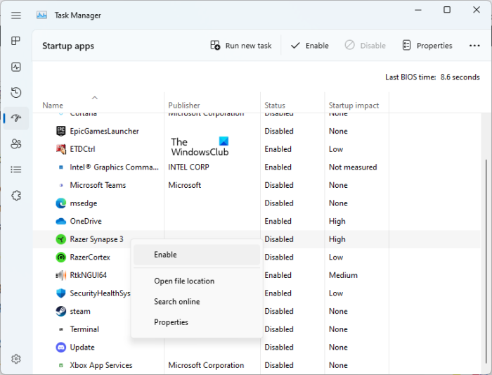

2] Check if it is enabled in Startup apps
Startup apps start automatically on system startup. In Windows, you can enable or disable the startup apps. This feature is available in the Task Manager and Windows 11/10 Settings. If you have a shared computer, someone may have disabled Razer Synapse in Startup apps. Check if it is disabled or not.
Follow the steps written below:
- Open the Task Manager.
- Select the Startup apps tab. After Windows 11 2022 Update, all the tabs in the Task Manager have been shifted to the left side.
- Check the Status of Razer Synapse.
- If its Status shows Disabled, right-click on it and select Enable.
This should fix your issue. If the Razer Synapse is already enabled in Startup apps but it is not opening on Windows startup, try the next solution.

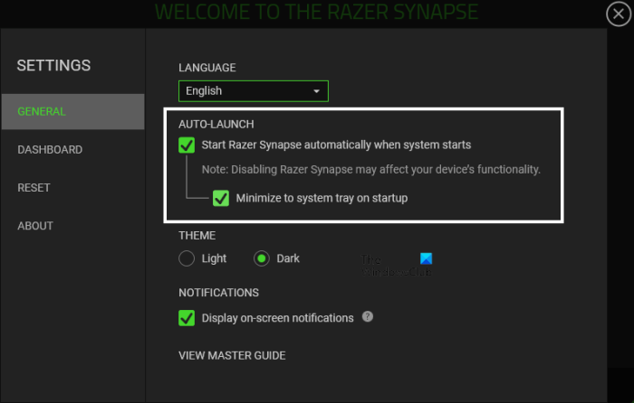

3] Check Razer Synapse auto launch settings
Check Razer Synapse settings. Incorrectly configured Razer Synapse settings also prevent it from opening on Windows startup. Go through the following instructions:
- Open Razer Synapse.
- Click on the gear-shaped icon on the top right side just before the Minimize button.
- Select the General category from the left side.
- Both the options under the Auto Launch sections should be enabled. If not, enable them.

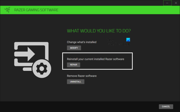

4] Repair Razer Synapse
Sometimes, the issues occur due to corrupted files. Windows 11/10 lets you repair the software you are experiencing issues with. If the above fixes did not help, repairing the Razer Synapse should fix your problem. Follow the steps written below:
- Open Windows 11/10 Settings.
- Go to “Apps > installed apps.” In Windows 10, you will see the Apps & features option in place of Installed apps.
- Locate the Razer Synapse app.
- Select it and click Modify. In Windows 11, first, click on the three horizontal dots and then click Modify.
- Click REPAIR.
Repairing the Razer synapse has fixed the problems of many users. Hence, it should work for you too.

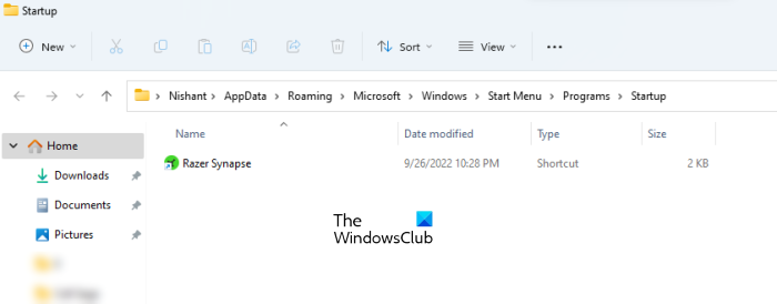

6] Place the Razer Synapse desktop shortcut in the Startup folder
Windows 11/10 has a startup folder. When you place the shortcut of any app inside this folder, Windows will start that app automatically on system startup. If despite trying the above fixes, the problem persists, you can take the advantage of the Startup folder.
To open the Startup folder, follow the steps mentioned below:
- Open the Run command box (Win + R).
- Type shell:startup and click OK.
The above command will open the Startup folder. Now, copy the Razer Synapse desktop shortcut and paste it into the Startup folder. If the Razer Synapse shortcut is not available on your desktop, follow the steps written below:
- Click on Windows Search.
- Type Razer Synapse.
- Right-click on it and select Open file location.
- Now, copy the Razer Synapse shortcut and paste it into the Startup folder.
After performing the above steps, the Razer Synapse app will launch automatically on system startup.
