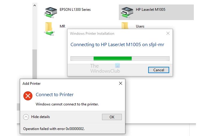

Are you getting the Printer operation failed error 0x00000002 when trying to print or accessing a network printer? In this post, we will give you the best solutions to fix this error. Here is the entire error message
Connect to Printer
Windows cannot connect to the printer
Operation failed with error 0x00000002
Error 0x00000002 usually occurs whenever the user tries to connect to a network printer or when you have remotely connected to a PC and accessed a printer attached to it. This error happens mainly for the corruption of the printer driver or incorrect printer configuration, or Network connectivity issues.

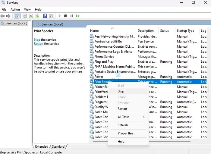

1] Restart the Print Spooler Service
Restarting the print spooler service can effectively resolve the 0x00000002 issue. The user must perform this process on the host computer connected to the printer. Follow the steps properly to complete this process.
- Press Windows + R keys simultaneously to open the Run box.
- Type services. msc and press Enter key.
- Search for the Print Spooler service from the list.
- Now right-click on the Print Spooler and click on Stop from the menu.
- Wait for a few seconds for the Print Spooler to terminate.
- Windows displays a Service Control window for a few seconds to show the discontinuation.
Now right-click on the Print Spooler and select Start from the menu to restart the service again and check whether the issue is resolved or not.

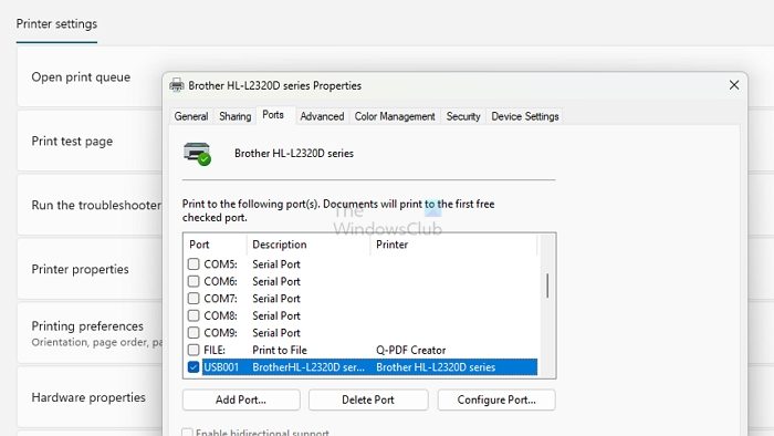

Before applying the rule, we need to find the port used by the printer.
- Go to Settings > Bluetooth and devices > Printers and scanners
- Select the printer to open its device page
- Click on printer properties, and then switch to the Ports tab
- Make a note of the port which we will need to unblock in the next step.

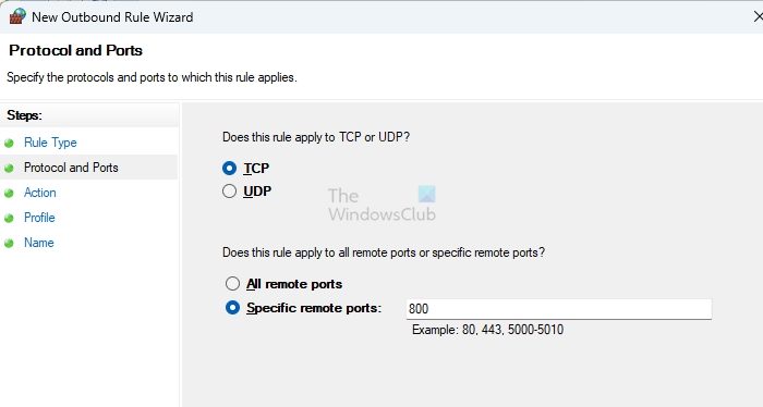

You can block a printer using Windows Firewall by following these steps:
- Open Windows Firewall with Advanced Security by typing wf.msc in the Run prompt and pressing Enter.
- In the window’s left pane, click on Outbound Rules.
- Click on New Rule in the right pane of the window.
- Under Rule Type, select Port, and then select TCP on the next screen
- Here you need to type the port that is used by the printer.
- Select Allow the connection and click Next.
- Ensure all three checkboxes are selected for Domain, Private, and Public networks, and click Next.
- Name the rule and such as Allow Printer, and click Finish.
Once you have completed these steps, Windows Firewall will block all outgoing connections to the printer using the specified port.
