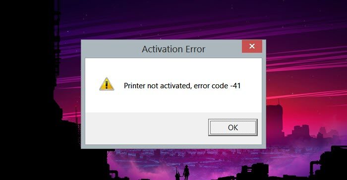

Some users reported that they received Printer not activated error code 41 error message while sending a print command to the Printer. The error in question can be due to glitches, corrupted device drivers, etc. According to various reports, Error Code 41 appears when a user updates from an older version of Windows to a newer one, especially when they update to Windows 10. In this article, we are going to discuss this error and see what you can do to resolve it.
Activation Error
Printer not activated, error code -41

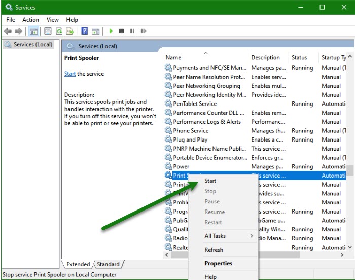

1] Restart the Print Spooler
Print Spooler is a built-in service of Windows OS and its role is to store print jobs in the computer’s memory until the printer is prepared to print them. In some cases, the Printer Spooler may be overloaded with too many printing jobs and this may lead to a problem. Restart the Print Spooler Service on your computer to resolve this issue.
- Press Windows + R to open the run dialog box.
- Now, type control admintools in the run dial box and press OK. It will open the Windows Tools folder on your computer.
- Double-click Services.
- Scroll down the screen right-click on Print Spooler and click on the stop option or right-click on the service and select Stop to terminate the service.
- Again right-click on Print Spooler and select Start to restart the Print Spooler.
Restarting the Printer Spooler service can resolve your current issue.
