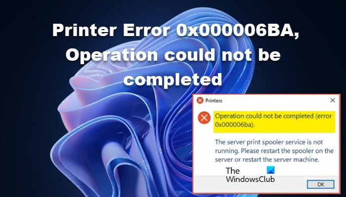

Printing a document using the Printer is quite easy, however, for some users, an error has made this simple procedure a hassle. They are seeing Printer Error 0x000006BA, Operation could not be completed every time, they try to print something. In this post, we are going to end this misery by presenting some simple solutions to fix this issue. Following is the exact error message users are seeing
Operation could not be completed (error 0x000006ba)
The server print spooler service is not running. Please restart the spooler on the server or restart the server machine

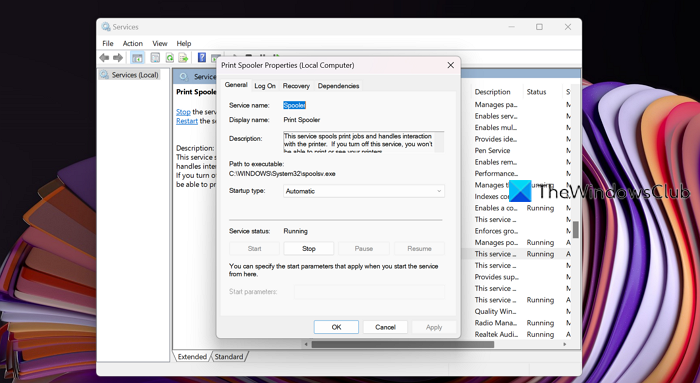

1] Start or restart Print Spooler Service
The error message clearly says that the Print Spooler Service is not running. However, sometimes, this can just be a glitch that can be resolved by stopping and starting the service in question. We are going to do the same on your computer and see if that helps. Follow the given steps to do the same.
- Open Services by searching it out of the Start Menu.
- Look for Print Spooler, right-click on it and click Properties.
- Set Startup type to Automatic and click on Start.
This will do the job for you. If the service is already running, you have to restart it. This will do the job for you.

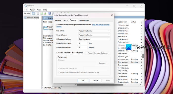

If this worked for you, go to the Properties of Print Spooler > Recovery tab and change the First failure to Restart the Service, and do the same for the subsequent options. By this, we are just automating a solution, as in the future if your system stumbles upon a Print Spooler error, it will be restarted.

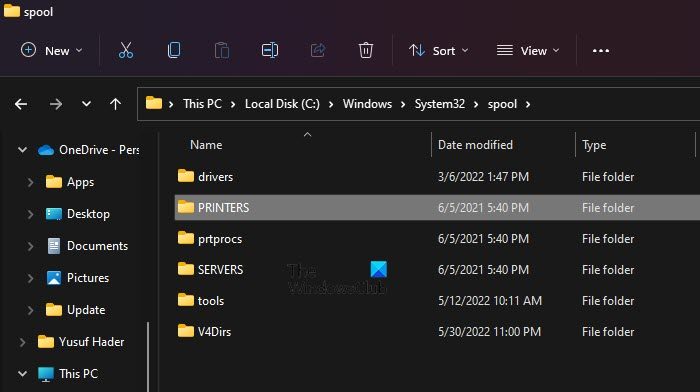

4] Clear Printer Folder
The Printer folder on your computer contains files from your previous and current printer. If any of those files are corrupted, you can expect to see this issue. We are going to clear the Folder and see if the issue persists.
Go to File Explorer and go to the following location.
C:\Windows\System32\spool
Double-click on the PRINTERS folder and delete all of its content.
