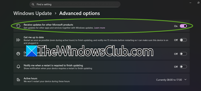

3] Check for Host Hyper-V Updates
The virtualization layer (Hyper-V) itself may have a compatibility bug with the guest OS version, especially given the different build numbers (host 26200, guest 26100). A host update can resolve hypervisor-level vTPM emulation issues.
First, check for Windows Updates on the host. Then, open Settings > Windows Updates > Advanced options andmake sure that Receive updates for other Microsoft products is on. Install any available updates, particularly for Windows Feature Updates or Hyper-V platform updates. After updating, restart the host machine and try starting the VM again.
