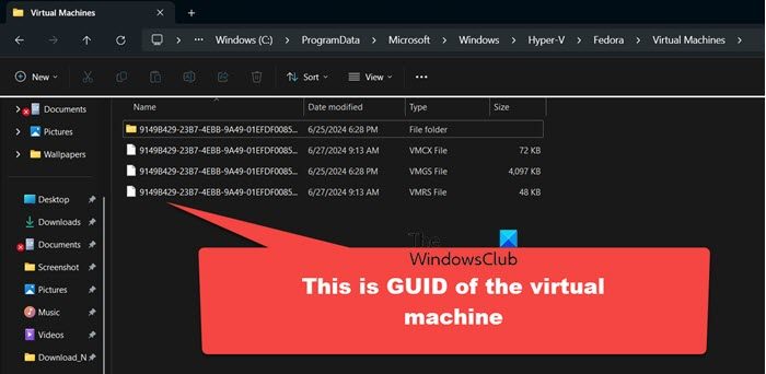

When encountering a start/stop VM error, you can’t simply terminate the VM by ending the Virtual Machine Worker Process (vmwp.exe). Each vmwp.exe process is mapped to a specific VM through a Globally Unique Identifier (GUID), so terminating the wrong process could result in killing the wrong VM, potentially affecting multiple VMs before finding the right one.
That is why we recommend terminating the process from Hyper-V Manager. Follow the steps mentioned below to do so.
- Open Hyper-V Manager.
- Right-click on your host machine from the left panel and select Hyper-V Settings.
- Go to the Virtual Machines tab and copy the address given there.
- Open File Explorer and paste the path we copied earlier in the address bar.
- Then, navigate to Your-virtual-machine-name > Virtual Machines.
- You will be able to find out the GUID of the machine, all the files and folders will have the same name.
- Now, open the Task Manager, go to the Details tab, find the vmwp.exe process associated with that GUID (It will be in the User column), right-click on it, and select End task.

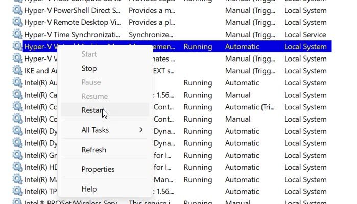

4] Check or restart the virtual machine service
If you are facing this issue with all the virtual machines installed on the host, there is a high chance the virtual machine service has some kind of issue. However, if only one machine cannot change the state, you might want to skip this solution.
Note: When restarting the Hyper-V Virtual Machine Management service in the production environment, interruptions to the Hyper-V services on the host may occur. So, make sure you have a proper downtime before rebooting the service.
To restart the service, open Services, find Hyper-V Virtual Machine Management, right-click on it, and select Restart if it’s running. If it’s not running, click Start.
Do this to all services related to Hyper-V and check if the issue is resolved.
