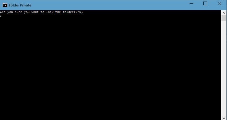

You should now see a file with the name, “FolderLocker”. Double click on it and it should automatically create a folder called Private, this is where you will be storing all your sensitive data. Open it and place your files inside, when you’re done, return to the file called FolderLocker and double-click it. You should see the following:
Type “Y” and press Enter. This will lock the Private folder, which will force it to disappear. If you would like to see it again, double-click FolderLocker again, but this time you’ll need to type the password you have chosen. Next, press Enter.
