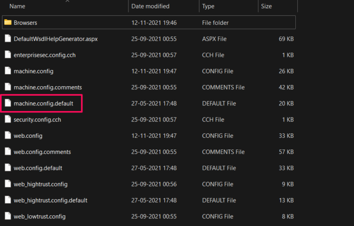

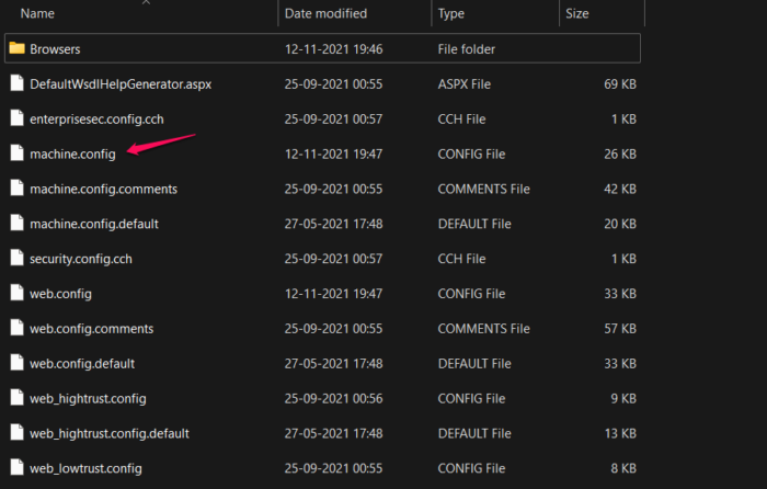

1] Replace the corrupt machine.config file
As mentioned above, the major culprit behind the issue corrupted machine.config file. The file is present in this directory:
C:\Windows\Microsoft.Net\Framework\v4.0.30319\Config\
You will have to replace the machine.config file with the machine.config.default, to solve the problem. Here are the steps you need to follow.
To begin with, open File Explorer on your system by pressing the Windows + E shortcut key.
Navigate to the below-mentioned location.
C:\Windows\Microsoft.NET\Framework\v4.0.30319\CONFIG
If asked for administrator right, click Yes on the prompt that pops up.
Select and right-click on the machine.config.default file. From the context menu, choose the Copy option.
Paste the copied file to a safe location.
Now, visit the above location again, and delete the machine.config file.
Go to the place where you have pasted the file.
Right-click on the file, and choose the Rename option.
Name the file machine.config. If any UAC pop-ups, choose the Yes option.
Now, copy the renamed file, and paste it to the below location.
That’s it. Now, restart the system and try to open the same program that was causing the issue. Check if the problem continues. If yes, try the next solution.

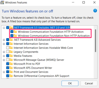

2] Enable .NET Framework from Windows features
The issue mentioned will occur if .NET Framework is disabled under Windows features. To solve the problem, you will have to enable the option. Here’s how to do it.
- Press the Windows key to open the Start menu.
- Type Windows features on or off and press the enter key.
- Double-click the .NET Framework option, and checkmark both the sub-folders under it.
- Click on OK to save the settings.
- Windows will look for the files, and install them on your system.
Once all the changes are applied, reboot your system. Check if the problem is fixed or not.
